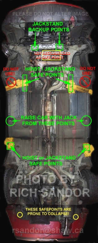

I've found this usefull for jacking info:-
Hi mate. You should only jack the car from the middle point with the arrow pointing to it. Then put an axle stand under the box section at the front or rear as required. Then repeat for the other side. Jacking from the front has in some cases resulted in distortion of the floorpan.

Thanks Scott - useful picture.
Had heard about all sorts of issues bending the floor pan etc.
So, will an axle stand on the front cross member as shown in the pic be ok - I notice the pic says 'back up points'. Then I can lower the jack and use on the other side? Or is the inner section a better place - as shown in the pic?

Hi Ian
I use axle stands under the chassis legs to support the front end.
The problem of bending the floor is mainly the area between the chassis leg and the "4 point lift" location when even using a large flat piece of wood it is possible to bend the floor slightly and have the accelerator stick - not good!
I wasnt the first and I know I wasnt the last to find this out .... all on my own!

Hi Mike -
sorry to sound totally dumb, but which bits are the chassis legs?

Hi Ian
The chassis legs are rhw box sections protruding forward from the flooreither side of the trans tunnel.
