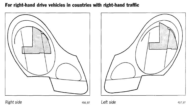

I will be heading off to Italy in a couple of weeks so I ordered masking foil for the headlights to comply with the regulations governing driving on the right and not dazzling oncoming traffic. When they arrived there were no instructions. Before I get on to PorscheShop where I purchased them does anybody have a set of instructions or a link to a DIY guide. Clearly I do not have zenons. What tools will I need etc Any help appreciated. Don't really wnat to have to go to my dealer. BTW my car is a MY00 986 2.7 and I am so looking forward to the trip.
Note the position of the notch in the mask, relative to the line on the headlamp glass:
Thanks guys. From the diagram I can't make out whether they stick on the outside i.e. on the plastic covers or inside on the lens of the light itself. I will get a jacket too as I have already heard of a mate who was challenged but let off when asked if he had one.
Outside. If you look at the lights you will see the lines to guide you.
