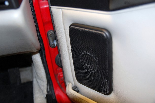

OK, here is pic of speaker grill, if I can work out how to post pics that is......![8|]
The metal grille is just pushed on and usually just pop off (the one on my s2 fell off evry time you shut the door)once it is removed the 4 screws are revealed that hold the outer black trim and speaker to the door.
Yep they are the same as mine, they have small plastic lugs, I think they should slide one way then lift off but could not tell you what way as mine have all snapped.
Had a better look at mine they have a big clip at the top and bottom then 3 smaller ones on each time, if you look you should see a small hole on the top, one on the bottom and 3 on each side. A small flat blade in these holes should release the cover.
The cover is mesh, with a plastic trim around it.
If you can seperate the two (easy), you can put some new paint on the mesh, which smartens it up no end. I used smoothrite and a brush, but an aerosol black would be better.
