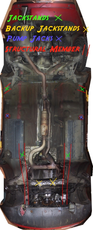

People say to jack the car up via a trolley jack at the centre of the sill. Axle stands I tend to put under the front chassis leg. Rear I am not sure about but there is a jacking point on the rear of the sill which can be used as an axle stand point (this all depends on how confident you are about your sills).
A place I'd suggest (but maybe others can suggest otherwise here) would somewhere on the torsion beam itself.
This is a useful schematic for this sort of thing.

Depending on your trolley jack, if it is only just too high try lifting the car with the car's scissor jack and then let it down very gently. You will gain a little height doing this and it might be enough. (or get someone to lift the car on its suspensions a little!)
My trolley jack fits very neatly over the jacking point which helps.
As long as the footing is secure there is no reason why you shouldn't leave the car on the scissor one side but I wouldn't want it suspended on the 2 jacking points. There are axle stand points marked on the image above.
