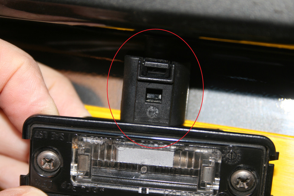

Picture attached showing original broken part out of the bumper.

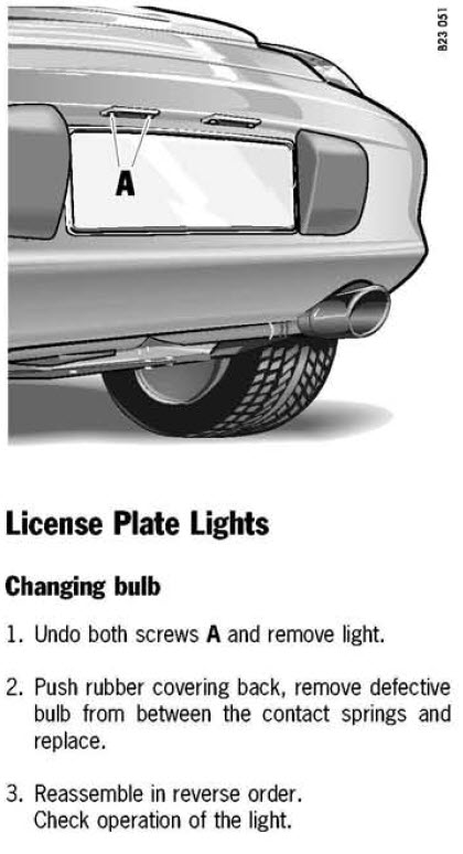

I'll take another look at the manuals tomorrow when I get to my PC, and see if I can come up with anything. I'll check the 997 manual too.
Nothing different is shown in the manual I have for the MY2002-5 996. The 997 manual doesn't show anything different either:
That is how I would be able to change the bulb (the lens/light part looks the correct shape), but it is replacement of the entire fitting that I need to work out.

I didn't actually mis-read it. All the manual says for re-fitting the light is "Insert number plate lights and tighten with the two fastening screws".
I appreciate that Nick is having a problem inserting the number plate light with the wires connected, although I don't know why. I haven't ever needed to do it, so I don't know if there is a knack to it, or something is wrong with the new housing. Presumably the old one came out without too much trouble. Nick - I don't think you would have much chance of getting your hand in to make the connection afterwards, and there should be no need to remove the PU to do the job. Maybe take the other one out and see if there is a difference. The owner's manual says the same thing, by the way:

Managed to install the new number plate light fitting at lunchtime, it was quite easy in the end. I used a wide flat bladed screwdriver to give some leverage on the side with the lugs (left side, pushing towards the right), this compressed the spring clip on the right side sufficiently to allow me to push the left-hand end with lugs up into the hole. Removed the screwdriver, then pushed the right hand end up and it clicked into place.
Tested the lights and all working perfectly.
