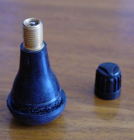

Tony - I have used tubeless tyres on various early 911's fitted with deep six & 7R Fuchs wheels for the past 10 years without any problems.
The tubes you need are TR415:

Hi Lightweight-911,
When you fitted the valves did you use any sealant or just pushed them in the rim?,
