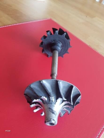

Cant entirely agree about the worst case scenario. The attached file shows the worse case scenario. I know not what caused this failure to my turbo in 2001. I had driven to a PCGB Sunday Meet along the A4 east of Reading (all 30/40/50 limits) having just finished the meeting I had driven a few hundred yards and saw this ominous cloud of blue smoke through my mirror. Yes it was expensive. the car had about 90 K miles on it
