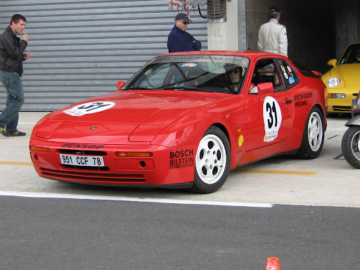

The items Im referring to can be seen in this picture.
Simon
It seems to me these black plastic mirrors, thicker than the chrome-ish ones fitted to the earlier 924, went into production sometime at the beginning of the 80s, but I could be wrong, and yes they were taken from the common parts bin when the Cup cars were built - I even believe that the shells are actually from the VW Rabbit.
As I now live near the German border and know a couple of 924/944/968 breakers around I could go and have a look for a pair if you can't find a set locally.
Send me an e-mail and I will give you the address of the company that makes the ducts. Last time I looked the pair cost about 30euros in fiberglass, a bit more in carbon fiber. I actually have a spare set lying around that was on my car when I bought it but I took them off as the French MOT don't like the omission of driving lights, and have since been looking at modifying them to fit some driving lights in them...
PS : this is Seb's car (Asarus) and yes we are talking about the same items. BTW the front panels for ducts are from the company I'm talking about, they are not original Cup items. The mirrors on his car are painted, which is not original either ;-)

Hi Simon,
Mirrors: the pic seems to have gone. Do you mean like these? If so, available from Porsche for about £300 a pair. Let me know if you want the part number
Just like that Sean. I apologise Thom: They were just as you say and my own car had (one of) these and not a flag after all. They werent painted in body colour either...[:)]

I remember spending a couple of hours with Seb (the guy with the red Cup car pictured above) partly taking the left unit off the door in order to replace the gasket but can't remember much from it apart that we miserably failed to make the new gasket seat properly with the base and refitted to old dry one :p
