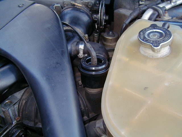

Mine is also a bit jerky at slow speed but I do have a new dump valve. To check yours, see if you can suck or blow through the top port. If you can, the seal has gone and you are losing boost. It's only a £35 part from the OPC and the new one has metal internals so will last a lot longer. There is a picture of it at the bottom.
The pipe that runs off the top of it leads into your vacuum pipe system. It's worth changinging all of those pipes as leaks are common and can transform the car. Contact a local hose supplier or motor factor and you can get about 5 metres of vacuum piping for around a fiver.

Just looked at the other posts in this thread properly, the vacuum pipe I was talking about is directly underneath the rubber pipe (connected to the hard pipe from the intercooler) top centre in the picture Diver944 posted.
