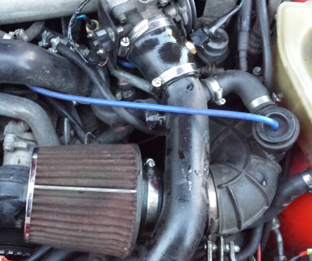

The original air filter has been removed and a cone type one is in use instead i will post a picture of the engine bay. would it be better to have a standard set up ? it fits below the metal inter cooler pipe its a pretty tight fit.
not sure if this makes a difference but the car has a MotorsportEmerald K3 ECU running everything including boost control, MAP Sensor etc.

Aha, so you bought *that* Turbo? ;). Plenty of potential with that IMO.
IMO I would look at the TPS connection. I have seen the connectors on these become iffy due to forceful connection of the plugs. It seems that may have caused issues previously judging by the wiring on the photo.
With that car running a MAP sensor as well, there is a chance that the MAP connection could be iffy in addition to the sensor being full of crud (cleaning it with carb cleaner may help. I would as the others said look out for boost leaks but I would expect the MAF to counteract that.
Furthermore, I see the inlet air temperature sensor (IAT) is in the silicon boost pipe. For me personally I would look at that area as a source of leaks unless you are sure that it does not leak from there at all. I would have preferred for the sensor to have been placed into one of the metal pipes with the relevant boss installed.
The air filter here should make that much difference IMHO.
Finally, I would get the Emerald software to look into some of the values the car is throwing up (it will tell you the throttle position, MAP reading, coolant temp, inlet temp etc.). While the software is free (http://www.emeraldm3d.com/software-manuals) The cable however may be the tricky part unless the car came with one (Dave Walker reconfigures a serial port cable to work with his ECUs). If this cable is not present I would personally be called Emerald to obtain another cable. I do have the software and cable if you happen to be close to Warwick one of the days.
He does offer a few FAQs on checking various sensors on his website as well (http://www.emeraldm3d.com/faq)

There's usually a hose connecting to the LHS of that hard pipe from the crankcase / AOS isn't there? Hard to see from the photos but is that now blanked off? I can see a hose just underneath - where is that going? Do you have a catch tank now?
When I had problems like this it was a boost leak - easy to miss & forget to tighten one of the connections, particularly the hard pipe / intercooler ones. This car is non-standard though, so much more difficult to fault find.
I see that the car has yet to be mapped which possibly could affect things. Before taking it up, I would ensure that the relevant bits and pieces are in order although you probably already knew that :).
ORIGINAL: edh
I think this ECU controls idle speed with an ignition table triggered below a certain engine speed and when TPS = 0%, whence the idle control valve and its hoses having been removed.

Oh I see
been a long time since I looked at a turbo engine bay - this one looks a bit scary...
