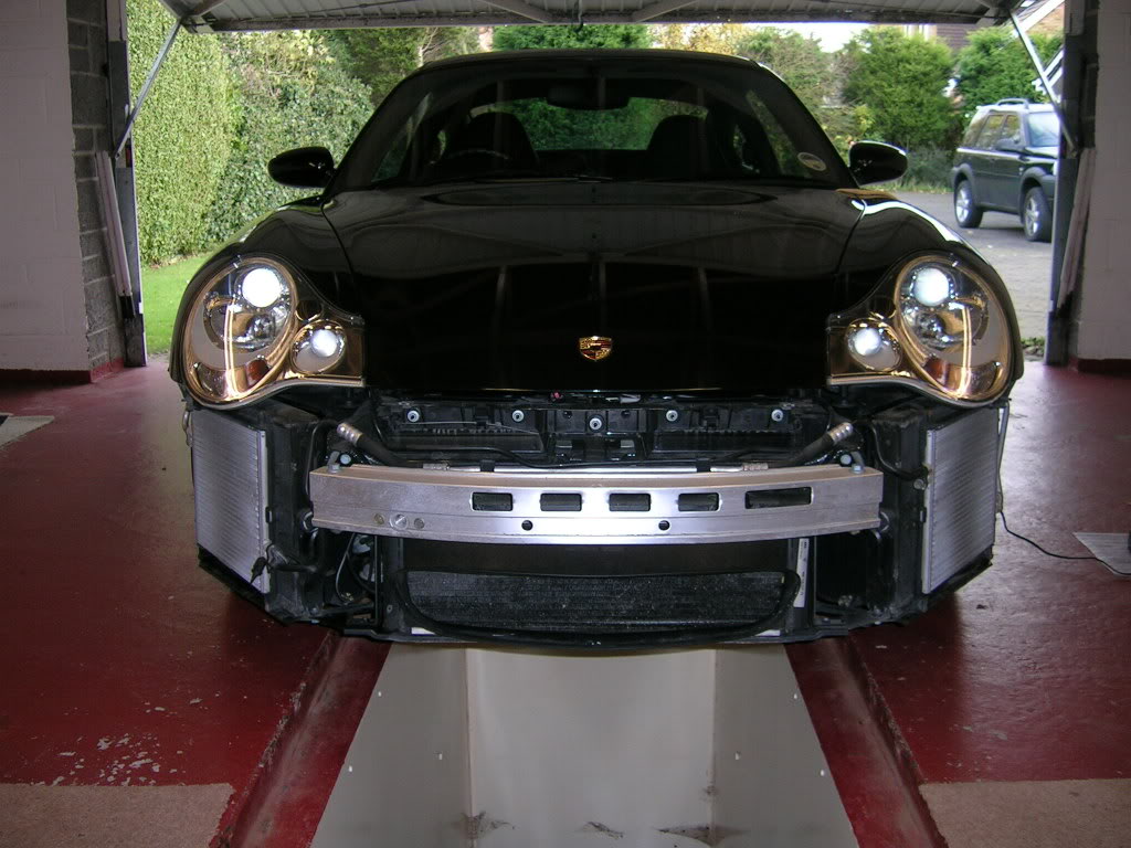

Here's a photo of a Gen 2 TT front with the bumper removed. There are 5 rads. here. 2 each side and 1 central.

So to confirm there are 2 rads each side and the centre rad? - where do the air con condensors sit? Main reason I am asking is I have found a place that sells OEM rads (Hella Behr) for nearly half the price of ones from Porsche and a friend of a friend is an ex Porsche engineer....just wanting to know what I should get!! The website is Advanced Radiators if anybody cares...

So the AC condensors are the things that sit just behind the front grilles and the rads sit behind them?
So at worst it would be 3 rads and 2 condensors?

Depends on whether it's coolant leakage or defective aircon that's your problem. [;)]
But these are the "usual suspects" when talking about rad. problems.
Remove the PU as per the link above and you'll soon see what's needed. [:(]
