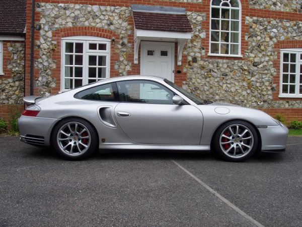

Those Ultraleggeras look nice, or how about the GT3 rims which were fitted to Turbos as an option:
John Ware's Turbo
ORIGINAL: Richard Hamilton
John Ware's Turbo
Yes they are much more to my liking.....I like the thin spoke options far more, the standard wheels look quite chunky (in my eyes!) sorry to those of you who love your wheels!
