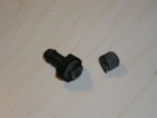

It's the small hose on the n/s top that connects to the header tank. The plastic fitting (944 106 927 00 I think) that screws into the rad looks like it has snapped. The piece that came out almost fell out, & it only has 2½ turns of thread. I'm guessing the rest is still in the rad - am I right - should it be longer? I didn't have time to take things apart to get enough access to try & screw the thing back in again.
The hose clamp had been tightened so tight that the clamping screw had bent - maybe this had fractured the plastic fitting? . If it's broken, it might be a pain getting this out of the radiator, but it must be better than a h/g :)

Here's the offending item - doesn't seem sensible to make this part out of soft plastic.
New part fitted - £3 from OPC - a bit cheaper than a headgasket
