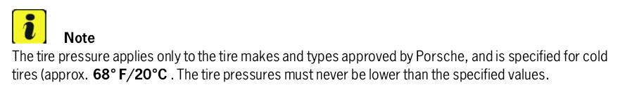

Seems very low to me. Porsche stipulate 36/44 (18" wheels) for a reason. FWIW I always run mine at those pressures and get even tyre wear, so I'm at a loss as to why your indy would suggest a 25% reduction.
I am not too concerned about this reduction. Whilt it seems a significant reduction is it? Given that all pressures stated are at cold I would allow a10 psi increase for a moderately driven car, resulting in 42 psi when warm. By the same yard stick at porsches recommendation warm tyres will be running at 54 psi.
