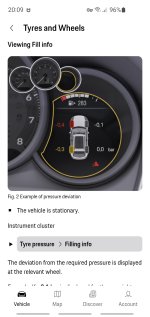

GB, it's a minefield isn't it? I know exactly how you feel, bern there! I now trust the TPMS to accurately measure the pressures taking correct account of the ambient environmental temperature and pressure so that I can just adjust the tyres in line with the recommendation in the MFD but, only after monitoring for a few days and decent mileage. This link will be of interest and if you search further in the Macan.co.uk forum you'll find acres more on the subject!
thanks all. I think it sounds best that I measure using the manual pressure gauge and just use the app and the TPMS to see if there are any significant deviations tyre to tyre. One last question; if I am measuring the tyre pressures in 70 million degrees below zero ( i don’t have a garage, and its been a tad nippy recently ), what allowance should I make i.e. should I inflate above or below the recommended pressures?
That's a calculation that's beyond me, needs an MSc in the relevant physics discipline and one of the reasons I've adopted the approach above, using this screen.....
