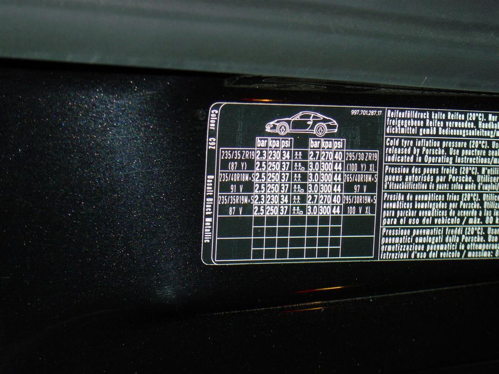

Front partially loaded 2.3 bar - 33.36 psi
Rear partially loaded 2.7 bar - 39.16 psi
Front fully loaded 2.5 bar - 36.26 psi
Rear fully loaded 3.0 bar - 43.51 psi

'Best' pressures are what the manual says. (2.3/2.7 bar or 34/40psi - with 2 people). These are at 20 degC, and so if you need to correct manually use about 4% per 10 degC temp diff, BUT if you've been driving it, it will be the wheel temp you need to know, not the ambient temp.
Even for a modest track day you don't really need to adjust as these tyres (with N-rating) are designed with stiffer sidewalls (rear notably) to prevent any creep off of the rim - you often hear of people putting extra air in for track days to prevent tyres rolling off of the rims but not necessary here.
