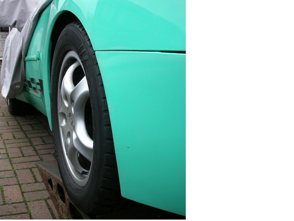

I need to change my 225/50,s as they rub the nearside arch roll under heavy braking.

I ran 205/55/16 on the front S2. These were on std D90s (ET55), but with a 7mm shim pushing them out (making them an "effective" ET48. They were still miles from the front arches.
Turbo's ran 225/50/16 on the front (and the 245/45/16 rears you mention on the rear). Their 7.5" front rims are half an inch wider than the S2 fronts but more heavily inset (ET65), so the outer face of the wheel/tyre has the same relationship with the wheel arch. Hence you could easily stick 7mm shims on the front of a Turbo running 225/50/16 and not have any fouling problems.
As you can see, not much room...and thats the side that doesn't rub!
No spacers or shims
I have medium big black callipers but do not know what the hubs are from.
