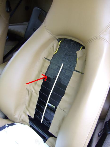

I've suffered from a bad back for a long time and was beginning to think that it was me and not the drivers seat that was the problem with my car. I have no problem with my wife's BMW or my Fiat Stilo!
Richard emailed me and suggested I put in a small foam pad behind the centre section of the seat back cushion as this had helped him so I thought that this deserved further investigation. Yesterday I unhooked the centre section of the seat which reveals the cables and springs etc that support the cushion. All was revealed - no wonder my back is sore!
The top third of the seat is supported by inflexible and rock hard expanded foam and its exactly the bottom edge of this that gives me a problem. The bottom two thirds is soft and springy then the top half is solid! Hence the 'joint' of the two differing supports its causing me pain!
I have no doubt that all 996's seats are built the same and my back is sensitive to this sort of thing. The car has only covered 8K miles so there is really no wear to report on the ruffled leather seats. Maybe the springs or cables are 'worn' or maybe the answer is to put more foam in the lower half and even out the support.
Whatever the answer is, It's got to be sorted before we embark on the clubs Early Years Tour to Austria & Germany in September.
Any ideas?

I drove it 12 miles in to work today and my back was beginning to feel the ridge in the seat back.. I am now convinced its a design fault by whoever supplies the seats to Porsche.
I'll try to get a photo on here later so I can explain where I believe the fault lies.
Sorted!!
Went to see the car trim man just up the road from where I work this morning and I showed him what was causing the problem. He couldn't believe how bad a design the structure of seat back support was. Anyhow he came up with the simple suggestion of a wedge shaped piece of foam that fitted from the base of the backrest then as it tapered from 2" thick to very thin, approx 1/2" where it overlapped the hard foam .
All I had to do was unclip the springs at the bottom to slide in the foam and the whole job took about 3 minutes.
Here is a picture of the seat before I fitted the foam which shows the hard part. The red arrow indicates the ridge area.
I'll let you know how get on when I take my drive home.

Drove home last night - and the ridge of hard foam is certainly less noticeable, but now the bottom half of the seat is too frim. I'll have play around this weekend to see if I can improve things.
On friend of mine suggests that I taper the edge of the hard foam by cutting off with a sharp knife. That would be rather drastic but maybe it is the final solution!
