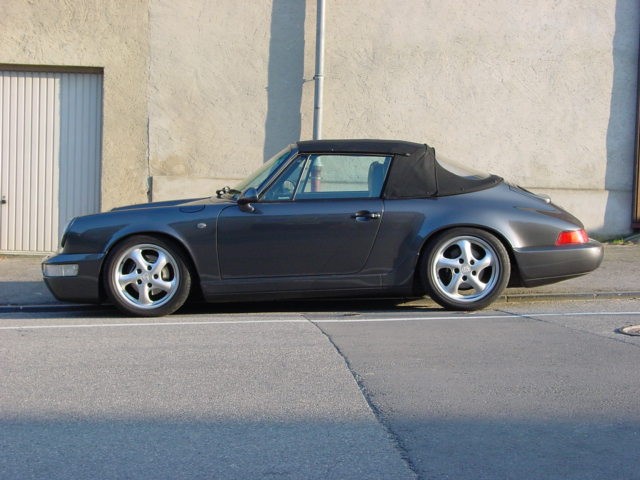

Mine's lowered & set up by Roock with H&R progressive springs.
Also got a Roock strutbrace.
There's still some understeer, but not much and only on the limit.
Very low though.......great.
