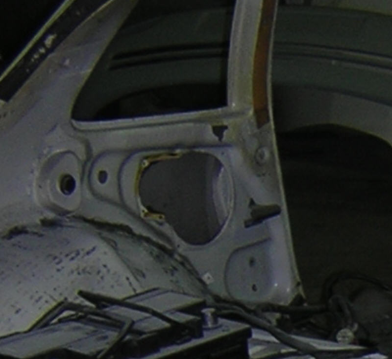

Here's the best pics I can manage at the moment, this shows the size of the opening when the mounting plate is removed

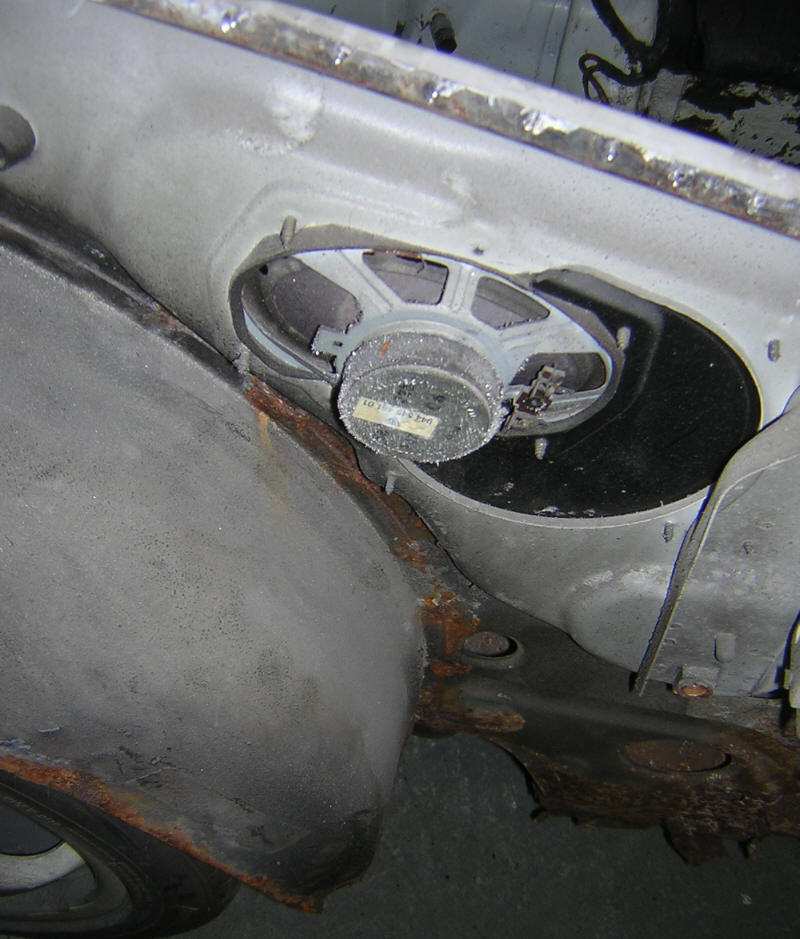

And this one shows the back of the speaker and its mounting plate (hopefully not a view that many people will ever see!). The plate is the black part, I assume you can still order the round 6" cut version from Porsche.
