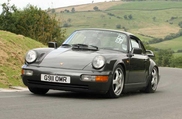

Also I think my car sits high at the front and feels unstable at high speeds. Would the car being lowered help?

As standard the 964 C2/4 sits fairly high. Lowering springs are available that lower between 30-40mm from £95 but you get what you pay for. It depends on whether you want to lower for cosmetics or handling. A lowered car should feel more planted at high speed (depends on how high??) but I would recommend a decent geo setup after changing the spring/struts or both, it made the world of difference to my C4.

great choice of new toy!!! first thing I did to my C4 was the suspension I replaced shocks and springs H&R 40mm lower ride height and it completely transformed the car. Great on track too. its a firmer ride on the road and feel more bumps but hey its a sports car and the handling is awesome.
