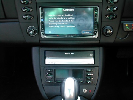

Yes I did a major upgrade using Kenwood equipment. Includes Radio, TV, SatNav, DVD & TV. Pic attached
Sorry - New version
Here is the picture

That installation looks excellent.

The Nav unit is the DV-3200
Screen/Radio/DVD Player is the DDX-7025, but there is an updated version coming out this month
TV Tuner is KTC-V500E
My car already had the PCM package so the Aircon controls were already in the lower slot. Susspect you can get a surround from Porsche-apart breakers.
I did at a a later stage install a 250W 2-ch amp and Focal K2 speakers in the front
I live in Surrey, so I cant give you any installer contacts. Mine was done by a local independent chap, who has a reputation with prestiege cars

I cant believe Gary that is what i am about to make the interior of mine look like!! i already ahve the DV3200 , KT725 (flip screen) DVD and kenwood music keg in my CSL and its all coming out of there to go in the turbo, but at the same time i am replacing the flip screen unit with the fixed one which is the one you have ( i think the fixed one looks more like oem equipment .. flip screen are all over the place these days ... ). Oh and i will but the nav unit under the seat as i have my cyclops wired into the spare tray slot.. dont need to get to the nav disc very often really!!
I use (and trust) Bannings of Guilford to do the work and give advice and theres is no point to wait for the new unit that replaces the 7025 as it is still 2 months away and going to be a lot more expensive and for what? nothing we can see from the blurb supplied by kenwood !!
My car did not have PCM so we have to move the heating controls down but bannings have done a few of these already and its not a big job. Maybe yours was done by them ? They are top guys and do work for Porsche Guilford and Barons and Mercs and even Williams F1 team! I was ther elast year when one of the big rigs was in .. amazing what they were fiting in that!!
The only issue i have at the moment is that the surround for the screen is a bit light in colour (dark grey rather than black). I have tried to spray one to match the silver trim but that didnt work so am going to have to spray it matt black now!!
