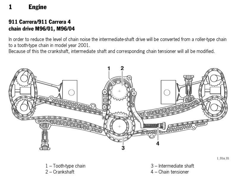

The intermediate shaft chain drive was beefed up for MY2001, but the gear drive wasn't introduced until MY2004.
You can get all the details of the 2004 mods from: https://techinfo.porsche.com/techinfo/index.jsp and go to GB>Training documents. The 2001 details are shown below:

Having looked at it again, I think I've made a c*ck-up there. The gear drive was introduced on the GT3 for MY2004, not the Carrera. Therefore, 911&PW have probably got it right about the 997 drive.
