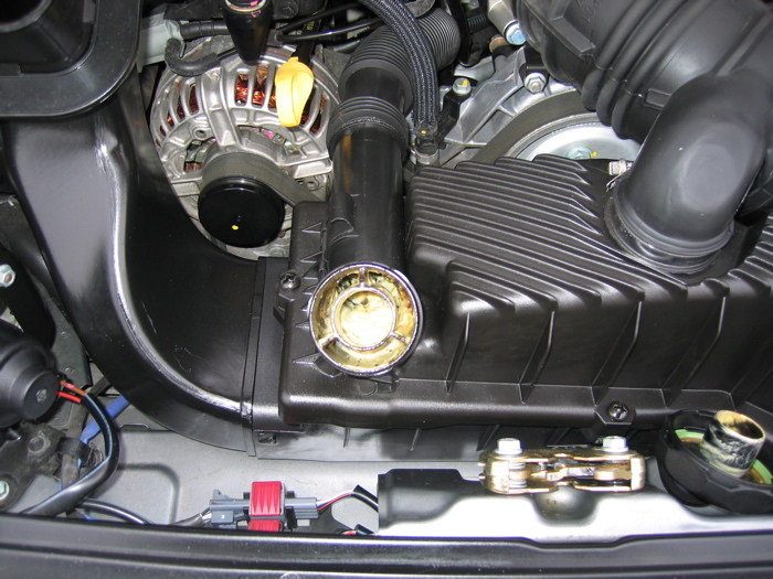

Hi Jon - or should I say, "au revoir!"
Check mine out for comparison (or "comparaison")...
