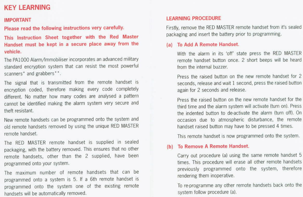

Can anyone out there provide me a simple set of step by step instructions on how to use the Red Master Remote, to programme additional Black remotes....?

Here is a copy of my Key learning instructions. Just keep in mind they are for a PA100 system.
Hope they help

Thanks this is just what I was after... Not sure why its not including in the Alarm manual I have..

May help you to know that these instructions (which are same as ones that came with my car) did not work for me.
I believe my PA1000 was replaced at some stage in the car's life and, although its still a PA1000 it is a slightly different version.
The important difference is that the instruction:
"Press raised button of remote new handset for 2 seconds, release and wait 1 second......pressed 4 times."
should be replaced by
"Press raised button of remote new handset 4 times"
No delays about required!
Once I was told this by Hamilton and Palmer it ended several weeks of thinking my car would need a complete new alarm system.[:)]
