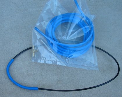

On the subject of vaccum lines may I "commend to the floor" Andrews/Lindsey Racing Purasil tube kit. Even if you don't do the whole of your engine it is great stuff to have in your tool kit for repairing vac lines - of which we seem to have hundreds.
You can cut the original tube and slip the purasil tube over the end to make a join - as shown below - and saved me a lot of hassle in repairing my boost guage line.

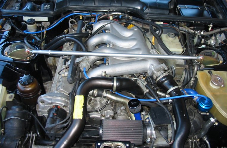

......looks nice and tidy in the engine bay as well.
Why am I saying this, most of you have done this already [;)]
Nice, tidy and clean engine bay there, Mr. Sims.
Thanks Fen,
It is one of the few places were a seven year old and a wife can't get involved and make it untidy. Santuary, sanctuary!
Hey John i have my purasil kit ready to rock with the gauge install, when you cut the origional tube and slip into the Purasil (as pic) how did you seal the ends?

The purasil has a strange sticky surface so provided the tube you are sleeving is slightly wider than the bore of the Purasil tube, and provided you push the Purasil over the inner tube by about 2", it achieves a seal all by its self.
If the original tube is too fine (ie its outside diameter is less than the bore of the Purasil tube) then you could have problems. If this is the case you may have to try flanging the original tube.
