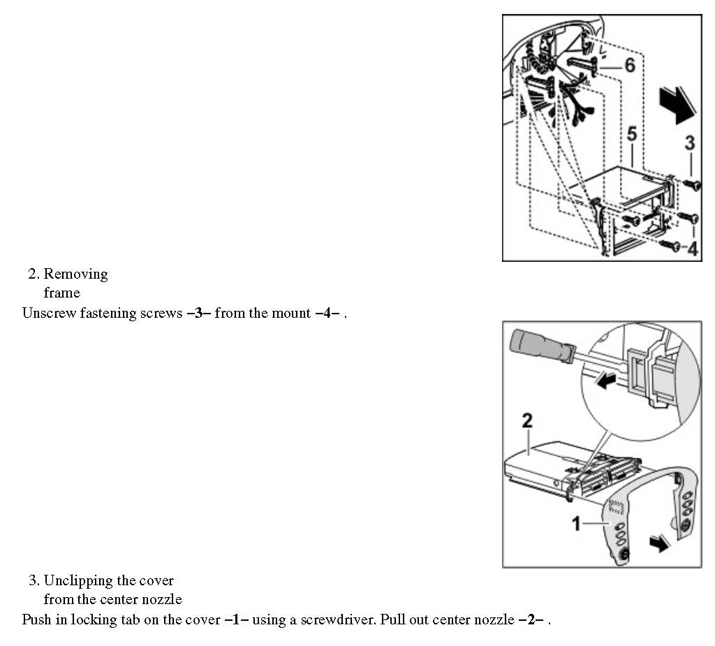

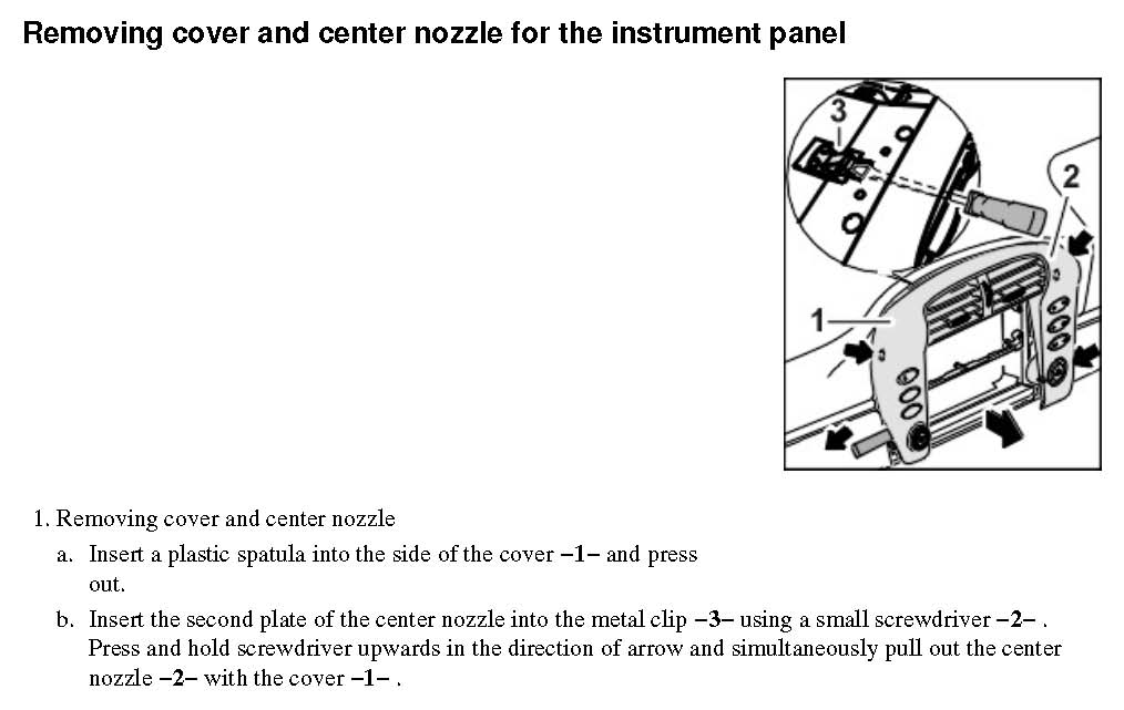

No - you have to unclip the switch panels at the bottom edge, and unclip the catch in the top vent.
