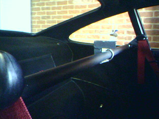

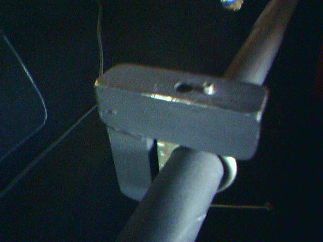

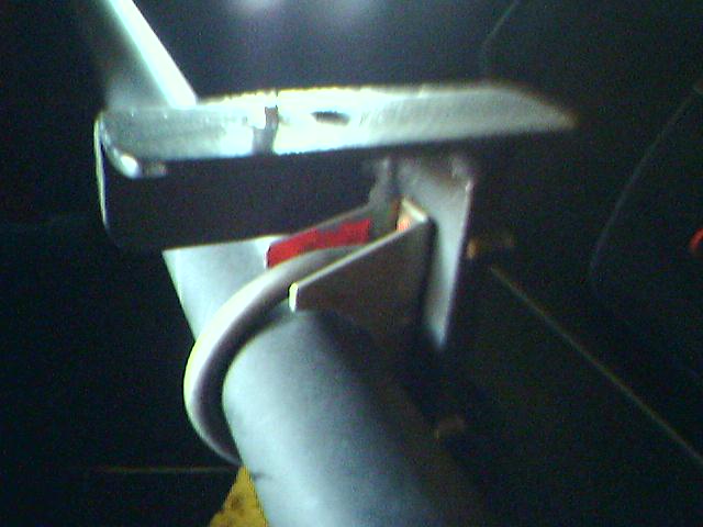

Thought you might be interested in seeing my "el cheapo" camera mount and bar. The mount is simply two pieces of 1"1/2 steel angle welded together to form an L as in the pic then simply drill holes to accept a exhaust clamp for the chosen dia of the bar you are using. dril a hole in the top so you can thread a bolt of the chosen size to corespond to the one on your camcorder. for extra stabilty weld a small steel dowel or thread to help locate the camera. It works and the whole thing costs next to nothing. Only minor downside is that it's a bit fiddly getting the bolt into the camcoder. You could make a T section which would make things a dodle.
