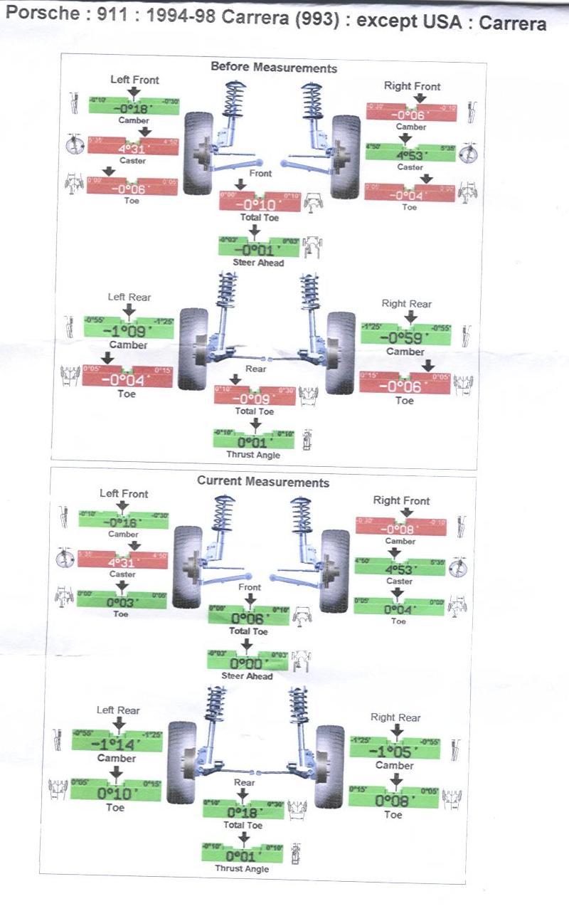

Maurice, I watched him adjust front & rear toe/castor but he said (?) that it was not possible to adjust the front camber..although I see that the readings have changed from before to afterwards?

As Maurice mentioned did he check / adjust the rear kinematic toe setting? I don't see it on the print out?
Where did you have the alignment done, and do you know what machine they used to perform the checks?

Hi Pete, I went to a specialist in Liverpool, recommended by another PCGB member. Place is also used by owner of OPC Chester. Unaware of any other adjustments, esp the kinematic toe setting. I think that a trip to an OPC is needed......
Hi,
Not necessarily an OPC, just someone who knows 993 suspension. The 993 is the only 911 model that has the Kinematic Toe setting, and requires a special tool to measure it, so you need to go to somewhere that is familar with it and has the tool
If you are in the North West there are several specialists who would be able to do the alignment properly - I'm sure some recommendations will be along soon [;)]
