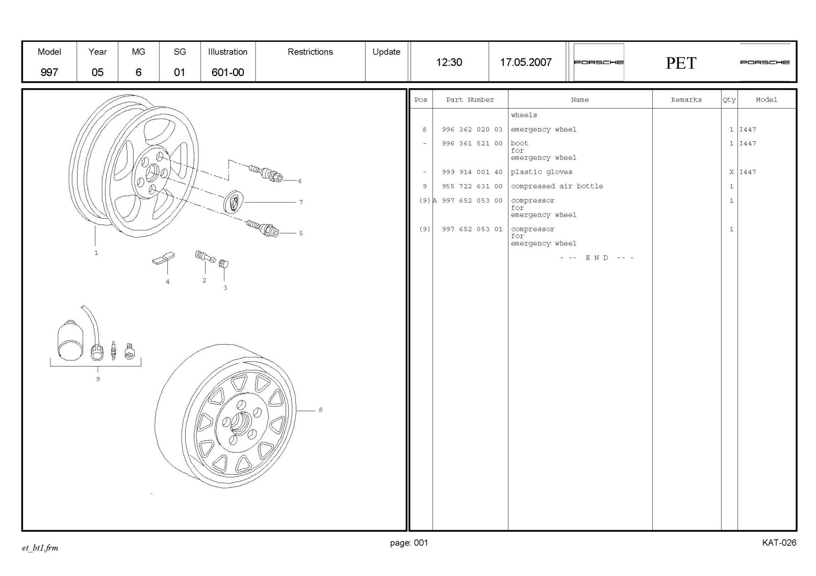

I got the numbers from the PET, which probably includes the tyre, although I'm not sure.
There is a space-saver listed for the 997 - 996.362.020.03 (see attached).
