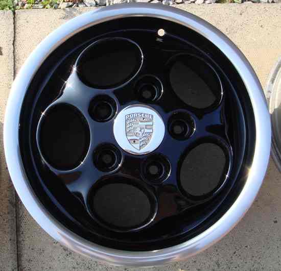

I only Like Cookie cutters..And of Course Fuchs (But too Exspensive)...and...a Thief Magnet!
Or Refurb with Blaak Centres!?...Black teledials?..
I had Teledials on my Alfa Spider But.....ummm.. Not on a PORSCHE>>>

What I do this to my Current Wheels?
