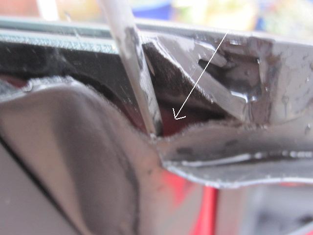

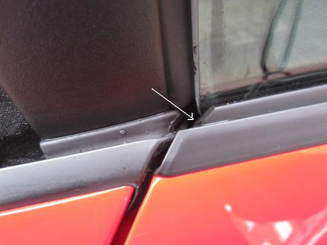

I think the water gains access to the door space on the "wrong" side of the membrane via the back edge of the glass that dosent quite meet the ruber seal in the fully raised position. as the pictures show (I realise these are in the dropped position) but a bit of duct tape over the gap kept the windows dry despite very heavy rain over night!
Car back from OPC today no leak found - membranes to be replaced to be on the safe side.

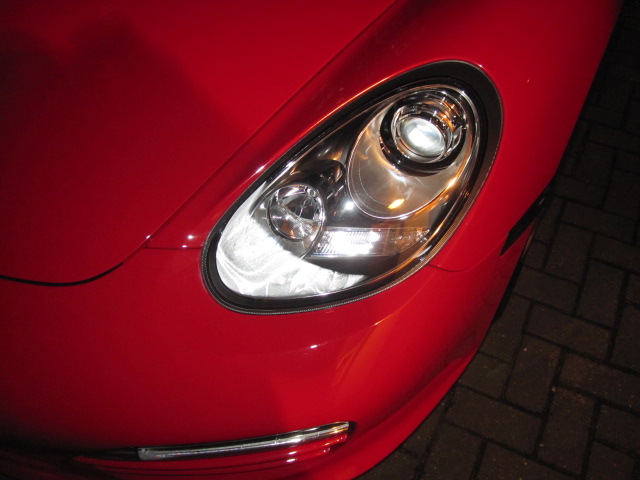

However when the car was delivered home this evening a Christmas snow effect, probably a "Porsche feature", was noticed when looking at the headlight unit!
Anyone else have this problem on the 2009 Boxter?
