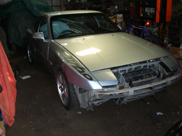

Here's my car with the badge panel and intercooler removed. The rad is out, too, but I think you can see that you would not be able to access it from there in any case.[FONT=verdana,geneva"] [FONT=verdana,geneva"]The S2 should be the same, except that the air-box goes where my intercooler does.[FONT=verdana,geneva"]
Cheers Fen,
Your pic shows the front of the metalwork that the bonnet catch engages with, and it's this same bit of metal that I'm seeing quite a lot of water coming through. So I'm going to run with my initial guess that it's not the rad but something above / in front of it that's leaking and have the badge panel off anyway. It's possibly a waste of time, but it's going to be a waste of much less time than dropping the rad out if the problem isn't there.
