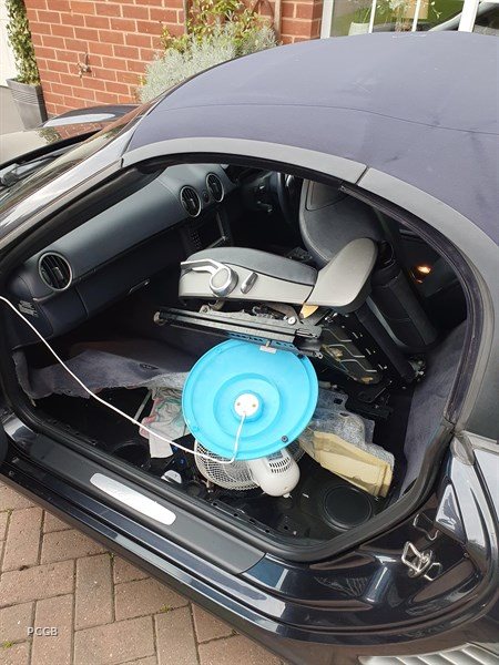

I have since replaced the ball joints and ECU. I managed to nearly completely dry the car (I say nearly - the foam under the seat is the most absorbent material known to man)
