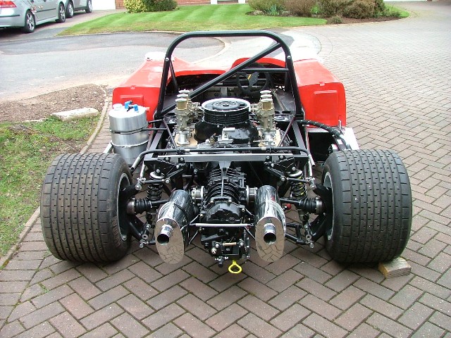

Hillclimb 3.2 , stock with 2.4 exhaust manifolds.
Webers: 40 IDT
Engine needs to be gutsy, high torque and very drivable.
Expert # 1 (well respected tuner): 33mm chokes
Bruce Anderson book; 35mm
Your experiences please??
