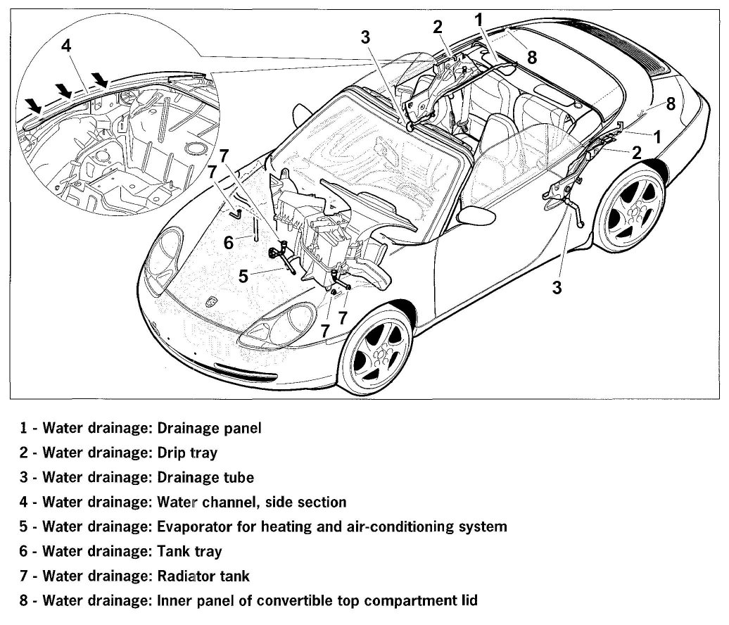

Thanks for the info gents. Much appreciated, especially the info on the similar Boxter problem. Does anyone have any info or pictures of where the darainage channels are on the car and where I should be looking to unblock them? I'm going to let the carpet dry out and head to the OPC if I get a recurrance.
Cheers,
Hilbert
The drainage channels att he front are the same as the Boxster, underneath the black plastic battery cover in the front luggage area.
I'd also check the carpetted area at the bottom of the door panels, as these will get wet iof the root cause is a failed plastic door membrane.
In my case the problem turned out to be badly sealed cable grommets in the bulkhead. So any water (weather or wash) was landing on the cables and running straight back through the grommet instead of draining away

I checked the drain under the front scuttle cover again over the weekend and it was in fact blocked. It's cleared now and the carpets are dry once more, so hopefully that is it sorted. Thanks for all the suggestions. It looks like this might be one to add to the FAQ's under maintainence, as the Boxter boys have done.
