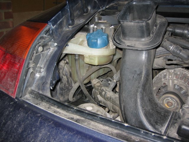

Well looking at that it looks fairly simple..
The air intake it best removed to gain access and then have a look at awhat hoses are attached at best there should only be two, one large and one small. Oh well ok 3 one would be a drain off incase of over filling but the bore on that would be very small.
The access to wiggle the tank out is what looks to be the problem.. I wounder if the OPC remove the engine.. but I am sure with some gentle pushing and pulling the bottle would come out..
The clips I can't see to clear in the picture but I am sure they are the usual speed clips and they are easy to move with the right tool. ( just taken a secondlook yep speed clips easy to move with a proper set of pipe grips.. ( double ones not the cheap halfords single ones that take half your hand off when they come off ......[:mad:] )
I can also see an area that I think might be the area of concern with the leak.. do these tanks leak at the bottom joint there?
If so I would say the reason is the tank is bottled very firm and the engine will move some what in driving and as there is very little of hose to the join there is not much room for the hose to take the flexing so it looks like the bottom joint on the bottle takes the brunt of it and hence the leak..
It does look an easy ish job to do for sure...

tip is when topping up run the engine with the cap off so when the termostat opens it pushes the water round any air will just bubble up in the bottle once your happy it's air free cap back on... looks an ok job to do .. save some money..
If you drain the system completely it is an absolute pig to purge the air out afterwards. The manual takes about three pages to describe the operation, and there are special tools involved. Best bet is to try and keep as much coolant in the system as possible. There is a purge valve on the top of the coolant tank, and it's best to run it for a day or two with the valve open and top up as necessary.
