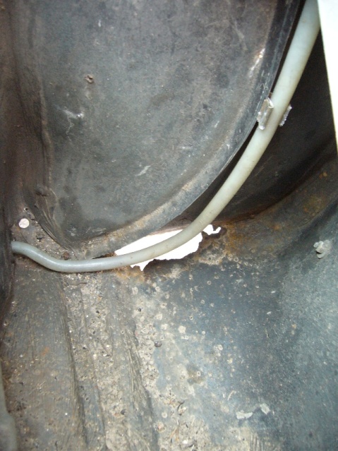

I'm not sure I should post this because I may want to sell my car, but hey, in the interests of the community and all that.
I wouldn't be too worried, I have exactly this problem, and mine is currently at the bodyshop being sorted, and for a very reasonable cost too. See below.
So if you like the car, and you like the colour (I do) then I wouldn't let it put you off.
If it gets repaired properly then it shouldn't rust - I guess it's just a note of caution to try & find out exactly what was fixed & why....
