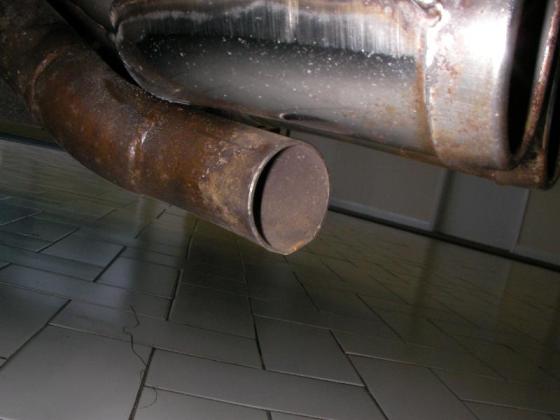

what`s this on this 86` turbo exhaust ?
tony`mac
as pic :
Looks like someone had added and additional lenght of pipe to your wategate muffler for some reason..
Probably a 'screamer pipe' straight off the wastgate. The 965/964turbo has a separate exhaust side for the wastgate, so Porsche already fitted the 'screamer' The 930 has only one exhaust, so second pipe is a mod. No performance gains but enhances the sound :)
