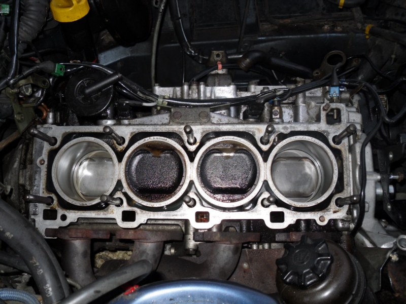

Thanks for that Gents I have taken the opportunity today to clean the pistons and engine bay in the snow. I discovered that my engine is a nice silver colour and the engine bay matches the paintwork outside.
