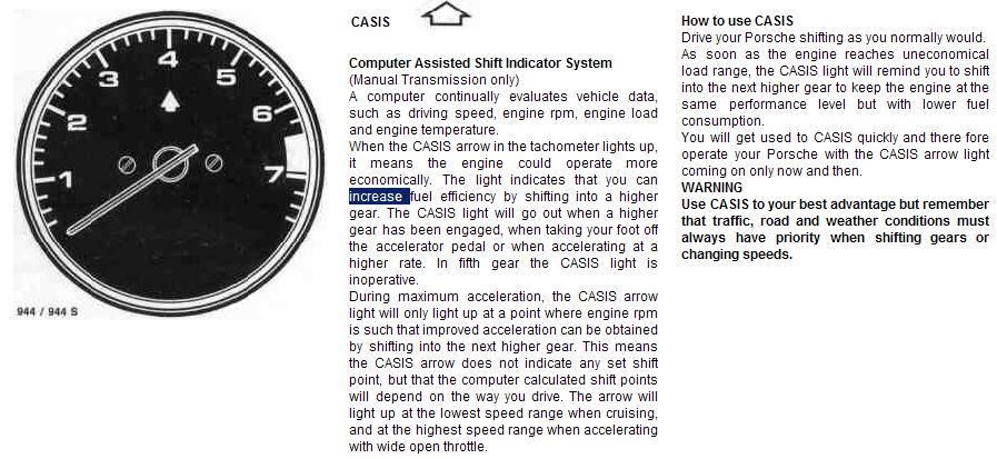

Under what circumstances does it flash - under accellaration, braking, or is it completely random? Also is it a solid diamond or does it have a symbol inside the diamond?
Every day is a school day...
Where the heck did you find that Jim, and what year does it relate to? Reading the blurb it doesn't sound like a shift light per se, but more like an economy meter [&:] I've never heard of it before and I wonder if it was an option that they soon dropped?
I know, it's not really a shift light. Well it is, but one optimised for fuel economy rather than performance.
My mother used to have one on a civic. Only it was green and had "Eco" written on it. I'm very suprised that Porsche could give a monkeys about saving fuel in 1986!
