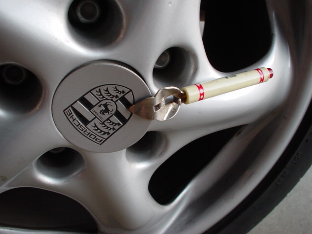

There is actually a special tool that Porsche sells to remove the wheel cap. A salesperson I know has one.
Looks like a bent piece of coat hanger with plastic tubing in the middle.

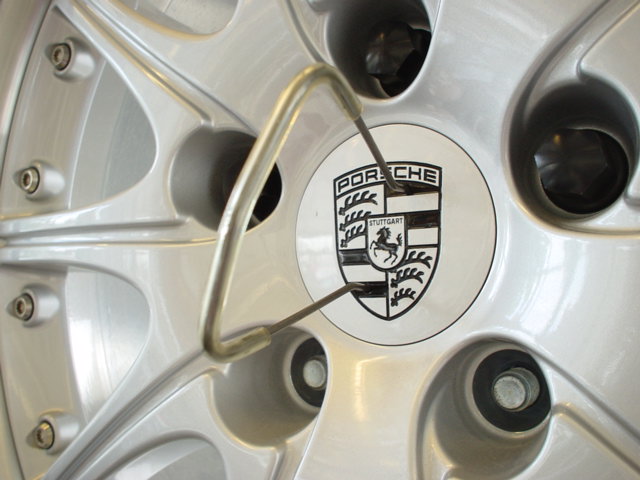

Crikey that all looks quite elaborate. I bent the last 2cm or so of a piece of coat hanger into just less than a 90deg bend. Carefully inserted it in one of the holes, and pulled. The only thing I tried to do was point the end in the cap along a diameter so that bit was laid along the underside of the cap. Worked time and time again without any problem.
The same bit of wire had a bend on the other end (which helps the above proceess by offering some grip), and it is also used to take the tension off the joining link when fitting/removing the chain from my mountain bike.
