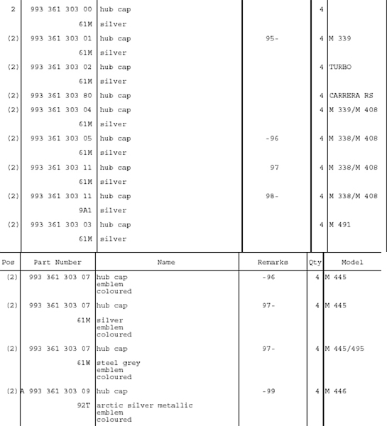

Hada look at the Porsche parts catalogue - there are lots of variants, and the listing is a bit confusing because the model designation isn't particularly clear, but heres the entire listing for wheel centres. Interestingly the picture on the parts exploded view shows a Porsche crested design, maybe this is just an example. I assume in the listings too that the 'grey' coloured ones are for use on the grey centred split rims ?
I'll leave you to decide which one is right [;)]
