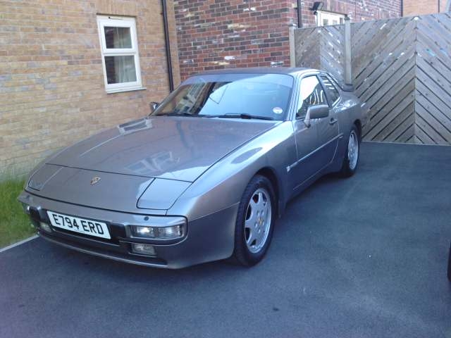

Personal opinion only as I think they are the nicest wheels ever made so here`s a great opportunity for me to show what mine looked like [8D]
The only others I like on a 944 are the forged D90`s
I (personally) cant stand later Porker wheels on them.
The 17" look good in the arch Paul, better I feel than the 16", But 18" must have small tyre walls, maybe 40's,. whats the ride like on 40's..............
nice colour, looks like stone grey to me [:D]
