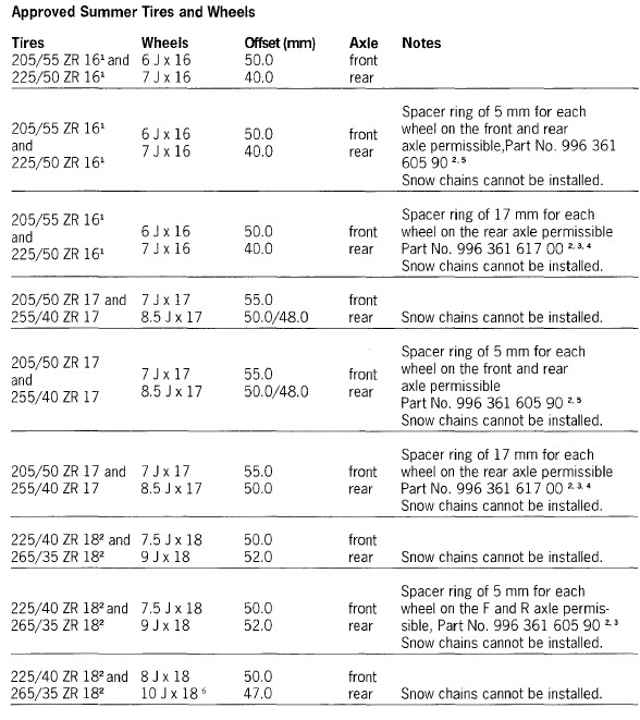

The best thing to do is get the widths and offsets from the wheels (cast in on the back of the spokes) and use an offset calculator to work out what you need in the way of spacers. The one I tend to use is: http://www.1010tires.com/About/Tools/Wheel-Offset-Calculator
The attached shows that 10" rears were fitted to the Boxster, so it is just a question of getting the spacers right. Bear in mind you will also need longer wheel bolts if you fit spacers.

Thanks for the info, the off set printed at the side of the valve is 58 and on the chart it sasy that the wheels should be 47 off set so may be a 10mm spacer would make them fit, what do you think?

An 11mm spacer will give you the correct offset, but a 10mm should be fine. Reading the TSB where that table came from, the only other thing you will have to do to fit 10" wheels is to fit an additional clip to hold the handbrake cable away from the rim. It looks easy, and if you would like details, send me an email and I'll attach it to a reply.
You shouldn't need to roll (swage) the arches, as it appears that 10" rims will fit underneath the rear arches of cars from MY1999-on.
