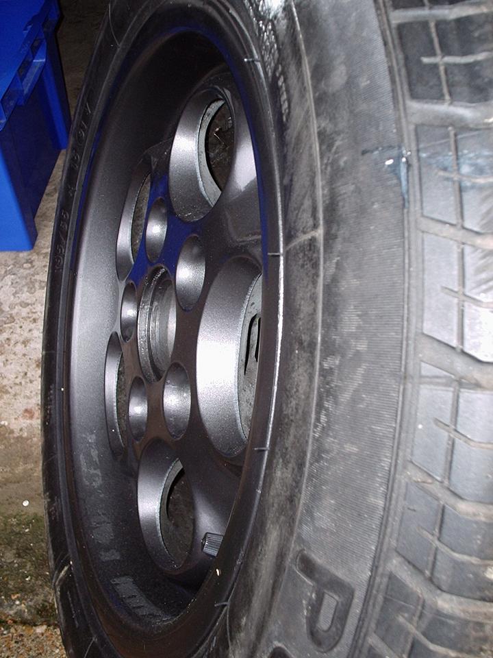

Grab them if you can get them, they look so much better than the 6" ones. They are very slightly dished, whereas the 6" wheel has the face of the hub sticking proud of the rim, which I've always thought looked a bit weird. I'll try and dig out some photo's that show mine better.

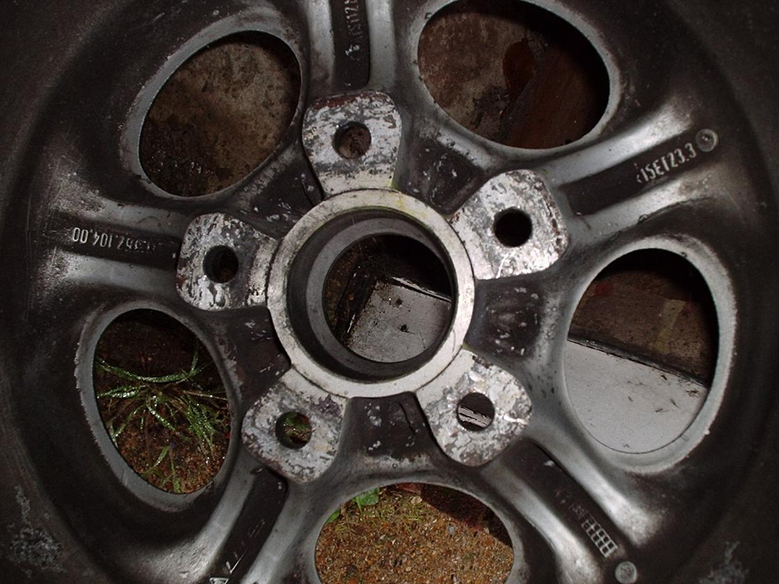

Tony's car should have later 52.3mm offset - Tone, if you get a chance before you buy the others, whip one of the wheels off and double -check the offset which is cast inside the rim - I'd hate you to buy something that doesn't fit on my say-so.
Actually I've got a spare 7x15 teledial (narrow offset so no good to me) in the garage. I'll take a pic tonight and show you what you're looking for. Anyone want a solitary 7x15ET22.3 teledial - in Graphite Grey of course, coz that's the way I like them.... [
cheers ....... Phil

ORIGINAL: antony ryan
The guy who's selling the wheels said the offset is 52.5!! Phil says 52.3 I don't know if there are different offsets or the guy is reading it wrong? HELP!!!!!
The offset is in millimetres so we're only talking of 0.2mm difference. I just checked in the drivers manual though and it's 52.3 officially.

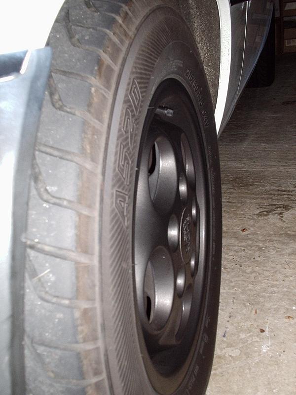

My tyres are 215/60's (look in 3rd photo) and they seem fine. That's what came on the rims when I bought them.
