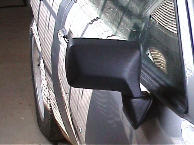

Forgot to add, when talking of the other mirrors did you mean like the ones that appeared on the Cup racers? (please see pic attached) They're quite similar to ones that appeared on the early VW Golf/Rabbit, however the bases are different apparently.
Thats the jobbies! I had a very close up look at both a cup car and a 924 carrera GTS, they both had these which to my eyes have/had a top part that is as near as dammit identical to early golf. The base though is completely different, I had some close up pictures somewhere and they don't look like any standard base I could find which is a shame because they would look great on a track modded 944 if all you had to was get some golf/golf clipper mirrors and mate up with a base from another car. ISTR that when I asked around the idea seemed to be that the base was bespoke for Porsche motorsport so likely insanely expensive, if they even have any.
Hi Neil,
these were the ones I've fitted to my 924S, as a token nod to its 924 Carrera ancestry. Still available from OPCs, listed in PET as 477 857 521 D for option M 637. Nice & rugged. As for insanely expensive, they're cheaper than 968 cup teardrops, which I considered, but dismissed, as in London districts, these now form an alternative currency to Euros, drugs and Pounds Sterling for the chavs.
Base attachment visible here Sligtly smaller than the flag mirror base, but not difficult to get a decent fit.
