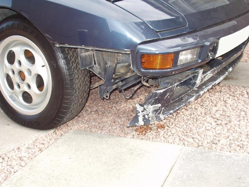

can someone tell me where the colour code is on my '88 944?
I cant see it under the bonnet and havent found the sticker in the boot - is there a definate location for it?
Alternatively, please see attached image

Sticket in the service book or sticker in the boot on the inside of the back panel.
Lools like a blue darker than Baltic. Same as Lemon's car?
Yep that does indeed look like my car.
In some lights it does look lighter than it is.
So I believe it is Nautic Blue Metallic.
I think they may have only done that coulour for year 1988.
What year is your car Gareth???

heres another pic. Car has been purchased as Cat C write off, and I have no owners book, and the sticker in the boot has been removed (or lost). The sticker under teh bonet, by the ecu, has also been removed. (i take it thats where the colour code should be)
I have friends in a bodyshop who will be able to identify the colour against a chart if i can't find it.

Only 2 blue colours were made for 1988 944's.
The first was a standard non metallic paint Azurite Blue code LY5D
And Nautic Blue which was a metallic paint colour code LY5Z
Youse definately looks like my met paint so I am assuming it is Naitic Blue
Hope this helps
Lee
Call an OPC with the chassis number and they should be able to give you all the option codes the car had and also the colour code (and original supplying dealer etc.) I don't know that the paint code is anywhere on the chassis plate.
