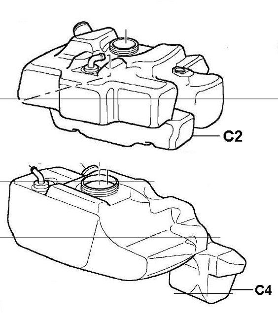

So I've collected car after having battery replaced. Fuel gauge light just come on so put £30 in... Restarted car but gauge light still on and trip says --- either all my fuel has leeked out or I have yet another issue? Anyone had the same?
This question comes up on a regular basis. The gauge on the 4wd models only operates on the top half of the tank as the tank is saddle shaped. After that it is calculated by the DME. £30 is probably just shy of reaching the gauge.

All you guys with 4wd models. THIS IS NOT A FAULT. Read your manual or my previous post. Or take your car to the garage and waste your money.

It also applies to the GT3, which for some strange reason uses the same tank.
I remember reading somewhere that it's only the RHD GT3. The LHD version has a long range fuel tank. Sounds like it depends upon where one puts one's column (as the actress said to the bishop).
