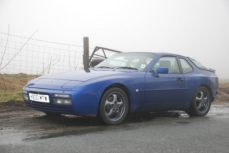

I was going to change my 18's for 16's in the interests of better handling but I'm used to the 18's now and the D90's look so diddy in comparison.

Those images really look good, its amazing how a 944 can wear 17's and 18's so well. Dont think any other mid-80's design coupe (if 1982 is mid?) could do it.
